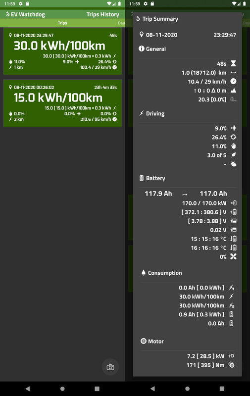

Beside storing the battery condition the App will also keep track of every trip you have monitored with it.
Each trip is kept on a card list (on the left) and by tapping the card you can have access to the details of each trip (right screen).
Details inside each trip card:
  • Date/Time it was recorded
  • Trip duration
  • Trip distance (odometer at the end)
  • Accumulated ascent / descent and elevation (from device's GPS)
  • Data resolution / error rate (from the OBD2 interface)
  • % of glide time (moving without motor or regenerative braking)
  • % of regenerative braking time
  • % of stopped time (without moving)
  • Eco score (efficiency score calculated by the App)
  • Weather season (inferred from GPS and calendar)
  • Charge at the beginning / end of the trip
  • Maximum observed power input / output
  • Minimum / maximum observed battery voltage
  • Minimum / maximum observed cell voltage
  • Maximum observed cell voltage difference
  • Average [target] cell voltage
  • Maximum cell voltage difference
  • Minimum / average / maximum observed battery inlet temperature
  • Minimum / average / maximum observed battery temperature
  • Maximum observed battery fan power
  • Charge difference at beginning (difference from previous trip)
  • Average consumption
  • Wall-to-wheel average consumption (without regenerative braking)
  • Total consumed charge
  • Average / maximum regenerative braking power
  • Maximum observed motor torque
