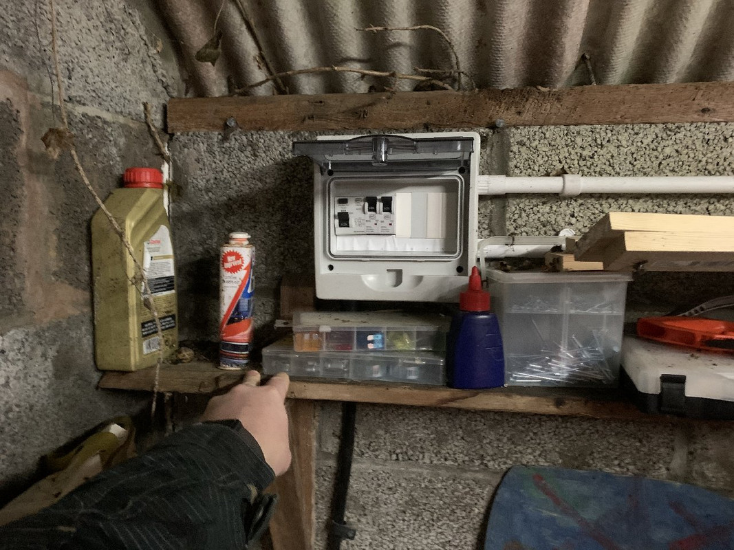

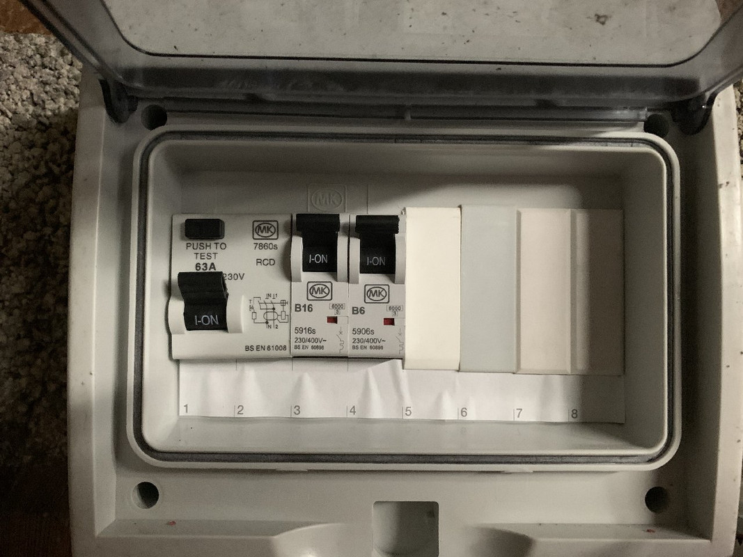

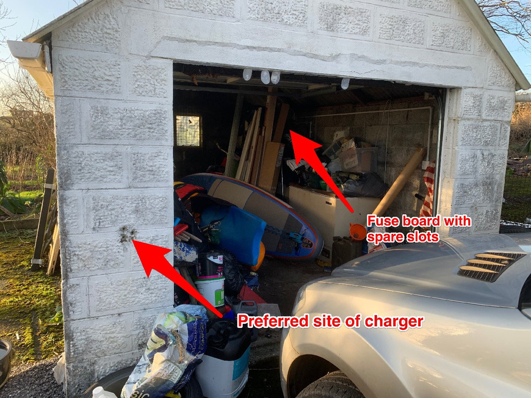

This is the proposed area for charger installation and the mini-CU (correct term?) in that garage:

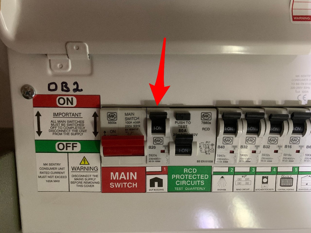

The electrician who rewired the house thinks the cable under the patio from house to outbuildings is probably only good for 20A: this is the value of the "fuse" for the outbuildings (picture shows 2nd CU in the house):

Your current wiring to the garage will most likely only be suitable for a 16A (~3.6kW) charger. That may well suffice depending on the car you are buying, your daily usage, and hence how much you would need to charge outside of your proposed cheap rate hours.

    At a cost, Yes. Do you have a main switch in the meter cupboard next to the meter? If so they only need to do between the two and your sparky can do the rest. If not then it could be expensive.

Assuming that your picture is oriented to the North, could you run a new cable to the South of the path and Garage 1 and mount the PodPoint on a post near to where the path meets the driveway? This would be a lot easier than replacing the rest of the wiring and because it is shorter require only 6mm^2 cable. It would also not involve digging up the existing hard landscaping, and the car would be relatively close to the house and hence convenient except you wouldn't be able to charge in the garages.

The weak wiring is only the stretch from house to garage 1 (the first thin red line), thereafter it is a chunky (expensive!) cable (the thin red line around the hard standing to the “barn” and second garage). So, if I understand you correctly, putting the charger at the end of the path would would be much the same as putting it on garage 1; both these locations partially block the drive (hidden by tree), hence getting charger further round hard-standing on garage 2 wall. A car can be tucked up near garage 1, though.

My electrician installed a new new circuit with a separate overhead power cable to my garage (obviously cheaper than underground). This might be a solution for you - although the distance from the house to garage 2 would probably preclude that.
