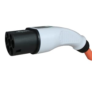

So I would like to ask, is there anyone here who would build me an EVSE, I will of course foot the bill for the parts and your time. I would like it to be a type two socket with a 13amp plug on the other end, happy for it to be set to something like 6-10 amps max, that way I could be just used anywhere as a backup.
Once handed over I will absolve you of all responsibility, so you don't need to worry about liability as should I plug it in while in the bath or something stupid,
Seriously though if anyone wants to take me up on this, let me know
