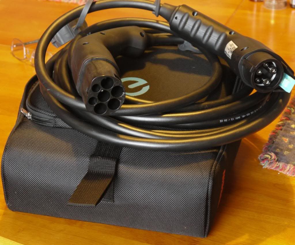

Our Leaf with the optional 6.6kW charger came with this Type-1 to Type-2 adapting cable.
We opted for the 6.6kW charger as it fits our usage pattern and the local public charge point infrastructure.
