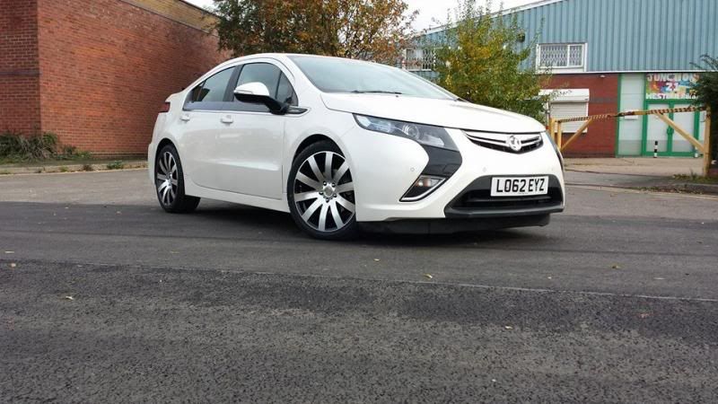

Ok so some info........they are the Decorrus wheel by Calibre wheels......they are actually a 114.3 PCD and although people do just mount these to 115 PCD as in the Ampera i used the so called Wobbly bolts.........terrible name with my engineering background!!! I find them perfectly acceptable however as they are only takung up in this case .35mm of stud/nut to alloy offset........got them from Wheelmania in Birmingham who also stock the most important thing.....70.3mm hub spigot rings........in the end i went for a 45mm offset 7mm away from the standard 38mm.......would have preffered the 40mm offset versions but think they would scrub the inner arch with a full load of passengers......to my utter suprise and being dubious from previous cars and messing with offsets the car drives perfectly.......even with the 245 width tyres!!!! A little stiffer but no tramlining or twitchy steering........really chuffed.
The only thing i may change in the near future is to a slightly narrower 235/40 r19 just because of the theoretical lower rolling resistence and the closer overall diameter to standard............the price of the alloys......and tyres..........£865!!!!! Including fitting balancing.....new chrome nuts and even removing the old tpms sensors and fitting to the new wheels..........i was extatic!!!!
Will report back over the next week how it effects the charge range.
Damien

One concerning thing was the old Michellins that were taken off........two of the four had "egg" bulges on the inside walls!!! They tyre fitter also said that they had the thinnest sidewall of any tyre he had ever fitted!!
