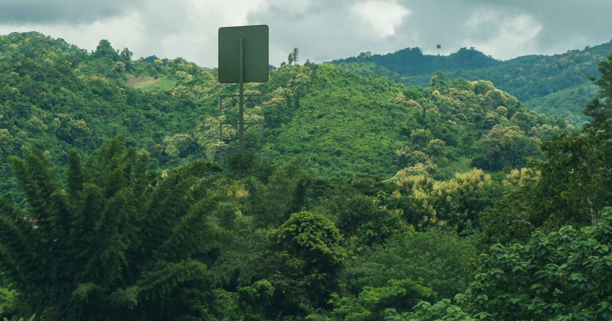

Is it April 1st?
Or is this for real?
Power your EV from a high tower source - as long as your car is in line of sight?
Or keep a battery topped-up without plugging in.
As long as you don't mind having a large plate receiver on the roof that is.

Good luck to them. In NZ with rough terrain, it might make some real sense to do that, from one high vantage point to another, clearly even if it wasn't that efficient the total cost for operating for X years to a small community might be considerably better than trying to erect or bury mains cable.
Sounds a good idea, for that country. I wish them well.
