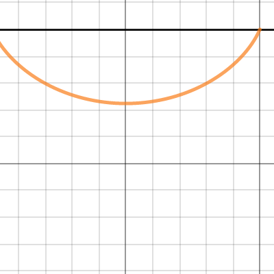

This shows a different version of my approximate solution, including the portion of the curve above the X axis that accelerates the bead to 1m/s at point (0,0):
134060
parametric graphing
^The whole curve is a perfect cycloid, but the size and positioning on the axes isn't exact, and we are only interested in the portion below the X axis with initial 1m/s.
