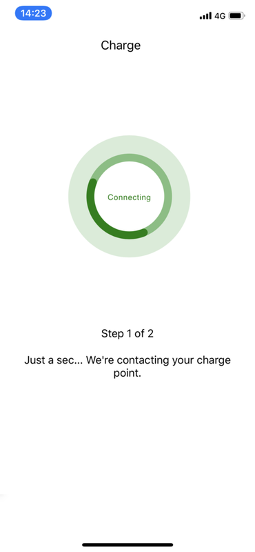

Since getting an iPace last week, my first EV, I have been charging with the Granny cable as my Podpoint doesn't work (see other thread: engineer coming tomorrow).
This has been OK to top-up so far since my most common commute is about 40miles a day.
However, I have a longer trip starting early this Saturday (5am) and since it is inflexible on timing I though I'd use spare time today for a tour of various DC rapid chargers I'm likely to use.
I was already aware of the flakiness of Ecotricity CCS charging, perhaps more so with the iPace, so I planned preferential use of Polar/BP Chargemaster and Shell (my route on Saturday will also try Instavolt, which sounds good)
I had registered the relevant apps, noting that the BP Chargemaster app migrated my account from Polar (Instant and Plus), for which I have registered as a "free" 3 month trial. I have no RFID cards (in the post still) but the apps claimed to negate these...
I tried three Polar/BP Chargemaster chargers, including a new-looking 150KwH near Newport, S Wales (not that the iPace can charge at that rate)
ZapMap suggested all were working but none of the three (CCS) worked with the app and the helpline could not fix remotely. The helpline did get Type2 charge going on my 3rd charger but at a lowly 2%/hr.
This is the screen the BP Chargemaster app always got stuck on:
I logged these issues on ZapMap and shall have to retry once I have an RFID card, until they sort the apps.
