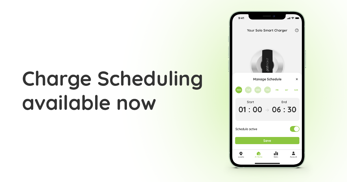

Pod Point have now enabled charge scheduling through their app for the Solo home chargers. Could be really handy for some MG owners and for me considering an MG5 in future and having a Podpoint, it is one less negative about the car...
Tks Will_12. I can confirm that after 3,000 miles with my MG5 it will not charge unless locked. It would seem that other MG5 owners get different results giving the only conclusion that there are multiple software versions installed. MG Support were useless and kept referring to the manaual. I installed a Rolec charger which works well. It trickle charges until the off peek tarrif and then charges at the 7KW.
