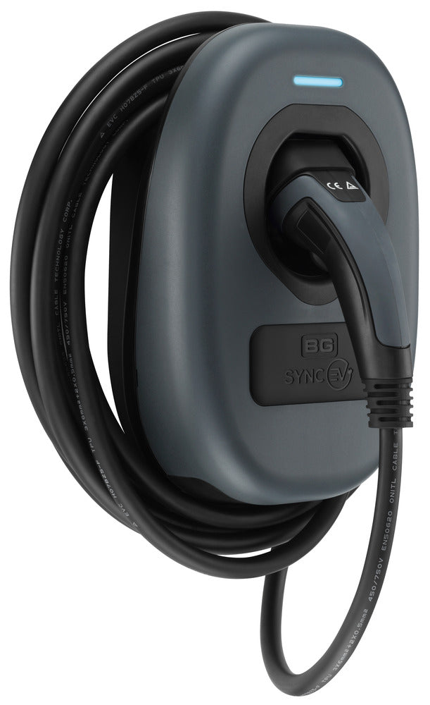

Hi all, I am looking for a new charger. The main criteria are:
1. Small(ish).
2. Tethered.
3. Ability to wrap cable around the unit rather than another holder for the cable.
4. Good value.
I have seen this which seems to fit the bill, so I wondered if anyone has experience of the charger. I did search, but could not find an exact match:
Thanks in advance.

Thanks, the rolec has a wrap around so does the BGSync, which is why I was looking. I have not seen the Anderson, but they look big in images, but neutral looking.

We fit chargers (south Wales, greater Bristol and M5 corridor down to Exeter currently) - and are fitting quite a number of this model, both tethered and untethered. OP is correct in your assessment of its features, and it is cheaper than the Zappi and Hypervolt others have mentioned.
I would add, it operates reliably using the Monta app; is straightforward to install and commission; and there is good UK-based phone support you can actually get through to, should there be any need for further help.
#15 ·
Thank you, good feedback.
Since I responded to the OP, just a quick update. We still fit plenty of these, no issues - but SyncEV have now improved their own app (which we used to commission the units) and it now has a customer-facing side to it. So the customer has a choice of app, either use the SyncEV app, which is perfect for most domestic customers, or Monta if they want more features (but more complexity too).

Just to share my experience. We have had our BG SyncEV charger for a year now and honestly we have not experienced any issues with it. I think that twice it went off line in a year and we use it about 4 to 5 times a week. Both times, we literally did a reset and all was fine.
Apart from that it works perfectly. The app is straightforward, we have set it up to charge from 12:00-07:00 and it works without fail. No issues at all. Only had one hardware/software update and that went without a blip of an issue.
It fits my brief perfectly; small, tethered cable with wrap around to keep things neat and it is great value.
