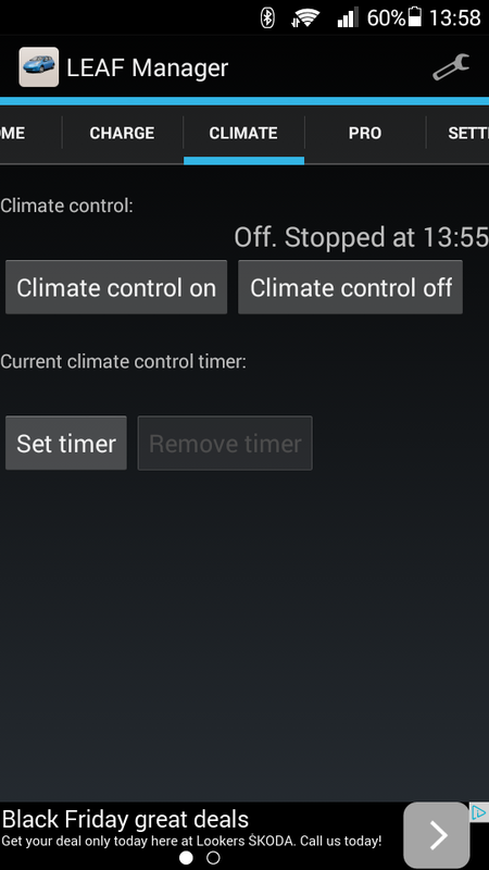

Can you preheat a gen1 Leaf if it's not plugged in?
2 reading
3K views 12 replies 5 participants last post by  Desserper
I believe you can with a gen2.
Or am I stuck relying on the app?
Only some of the servers have the option (go figure).

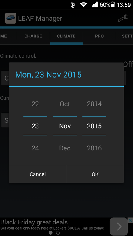

As I understand setting the timers on the servers, effectively schedules a request to turn on climate as per the app.
It doesn't set the timer in the car as such hence it should work on Gen 1's as well.
Personally I would be wary of something that can regularly turn on the climate however it will never run it _completely_ flat as you need IIRC 15% battery to turn on climate (pre-heat).
