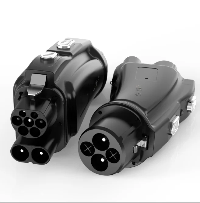

My apologies if the post wasn't appropriate. I myself have been a Leafer since 2022 and the very reason I sourced one of these adaptors was of personal interest. As I have collected more data for the maker to tweak the firmware, I ended up importing them and selling it locally.
Yes its a commercial post but I hope you also notice that the price is substantially lower than the £1200 price tag by another UK vendor as this is my side hustle and I havent reached the VAT sales threshold.
Either way I hope the product is something useful for Leaf owners.
