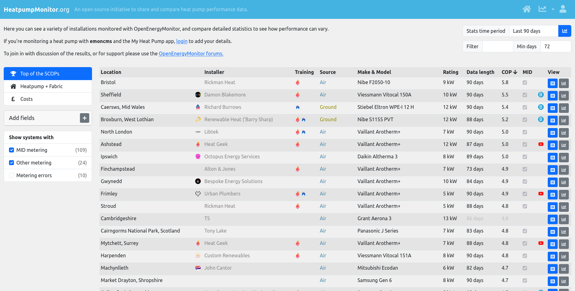

Our SCOP this year is 5.2 on the aerotherm+ , with Octopus Tracker averaging 18p/kWh , it's working well :)

I am just on 11 months with my Daikin 6kW ASHP, and for heating my average COP is 3.8 with probably >95% of my heating via the IOG 7.5p/kWh off-peak rate directly or via the same added into my 13kW of batteries. Not a brilliant COP value, but not horrible either.

I can't comment because I just went with Octopus and no other surveys. They did replace all 10 radiators in my house to achieve their design against a 4.9kW Building Heat Loss and 50C Leaving Water Temperature with a Design External Temperature of -1.9C. Their design defined a SCOP of 3.43 for heating, and at 11 months since installed my average shows a COP of 3.8

When I checked a few weeks ago, Heat Geek were guaranteeing a SCOP of ~3.8, I think, for every installation. They seem to have backed out of this now, guaranteeing that the installation “will be at least as efficient as quoted on your proposal”.
The Heatgeek installers unofficially compete amongst themselves to get the highest SCOP but I'm sure other installers can do a decent job as long as they do a proper heat survey and size radiators, pipework and heatpump accordingly to get the most efficient design.
