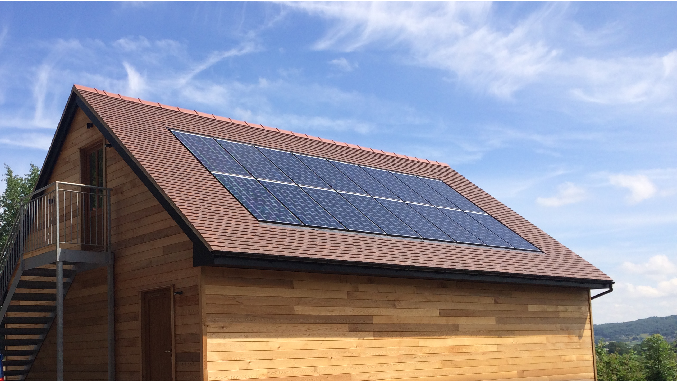

I liked the roof integrated panels, where the tiles are removed and panels become part of the roof, there's a few manufactures, some a dedicated roofing panels, others are mounting kits to turn the panel into a large tile. Wholesale prices for the components looks pretty affordable, not much over regular panels.
Be interested if anyone has had these fitted and how the got on.
Viridian Clearline
GSE Roof integrated mounting kits
