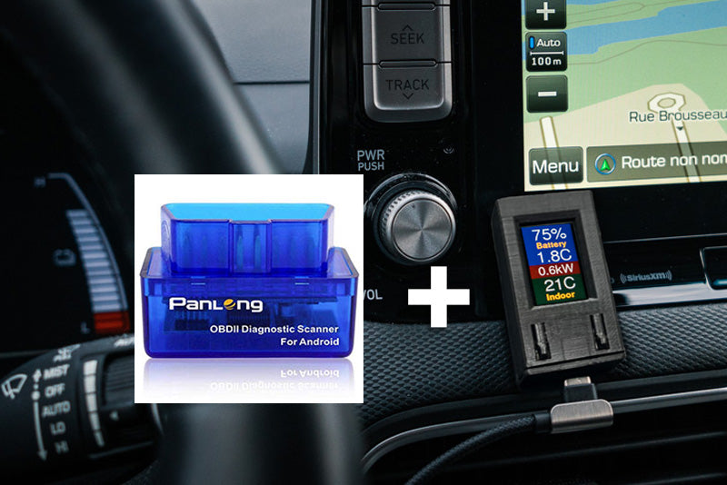

Apparently this set-up/device has minimal draw on 12v battery
and supported by former Kona owner
