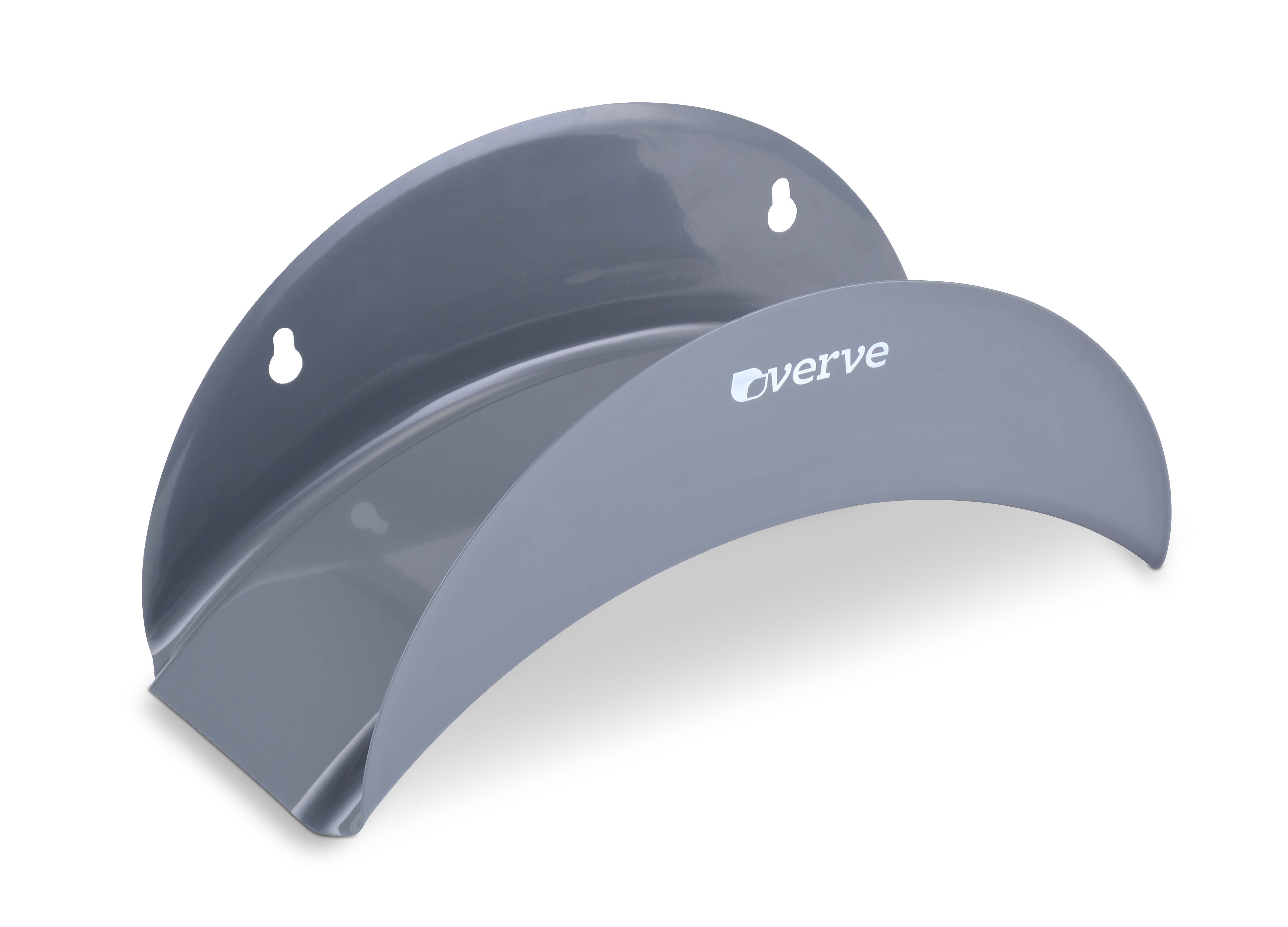

Add a spindle next to the EV charger. The cable has a place to wrap around now. And you can unplug and just reel off the cable to charge your EV.
I'm going to make this my next little project and will assemble parts and will show you in a few days 🧐
As long as you lot don't laugh out loud too much, I'll consider it mission accomplished.

Just reading up on replies...
Gaz: that looks neat. But I think you are a cheating a little using the bit of velcro to keep the wire in place!
I've bought a spindle and researched how best to fit next to the EV charger.
I've tried it and it looks nice.
Damn: the location I have the charger means I don't really have space for the spindle!!
I'll try and post a pic.
But... I think a much better idea would be a box around the charger as suggested.
And/or just add plastic around the charger to hide the dangling wire. But retro fitting won't be easy I think.
